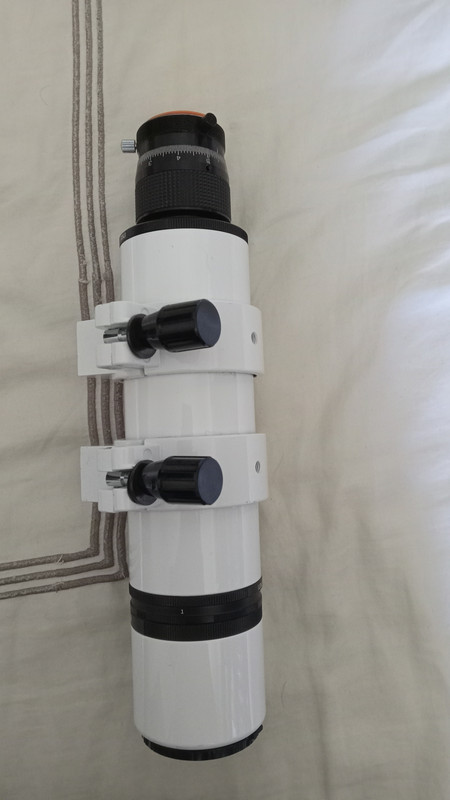

Attaching and aligning a 50mm Mini Borg (Or other small refractor) to an SCT
I'm trying to add a small refractor and create a superfinder like Televue calls it here: X-Y Mount Superfinder System
The little borg already has mounting rings or clamps which is great because I never
liked those overly sized rings with all the screws and stuff sticking out.
The bottom holes are regular 1/4 - 20. I'm trying to find the proper mounting plate and shoe
that will fit in a regular vixen base tail. Not sure if it's a Synta or an Agena version I have on my 11" CPC SCT.
I'd like to align it with the view of the main scope.
The little finderscope barely weights half a pound so no weight or balancing issues, it take a 1.25" diagonal also.
Does anyone have a preferred method or way of making all this happen?

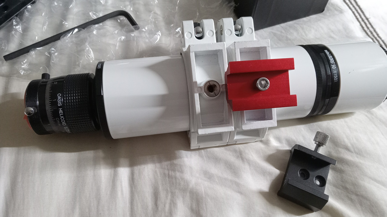

I went a different route after spending so much time looking for
something after I posted this.
Since there's 1/4-20 holes on the two clamp rings,
what I did is order these 3 parts to put on an extra simple finder mounting base I already had on the CPC 1100.
https://agenaastro.c...a_s_length=6922
https://www.aliexpre....1e5b1802C4aG8E
That Ballhead Tripod Mount Adapter seems to hold 8kg? We'll see. But all this for about 25$ looks fine to me and worth a try.
I might need a D-ring Camera Mount Screw also, but maybe not.
The whole setup with the borg should weigh about a pound, so it's not much. Maybe 1.5 with a 2" diagonal if I decide to use one.
So you prefer straight through huh?
Edited by Procyon, 29 June 2025 - 10:30 PM.
