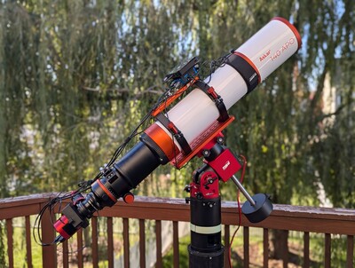

I use the Mele mini PCs in both my rigs. I have the older Quieter3Q as well as the Overclock 4C. Both use the same 3D Printed mount I designed and printed. One of them is mounted on top of a Pegasus PPBA V2 and the other is mounted straight to the dovetail.
Both of them are powered by LiFePO4 power stations in the field as well as 12V AC-DC adapters while home.
3D Printed mounts I made for these Mini PCs:
PPBA Mount:
https://www.printabl...uieter-and-over
Dovetail Mounts with various orientations:
https://www.printabl...nta-finder-scop
https://www.printabl...-scope-mount-fo
For SVBony dovetail clamp:
https://www.printabl...ium-clamp-mount
Mount for Gl.Inet Opal travel router (using 3M dual-lock to mount to any flat surface)
https://www.printabl...telescope-mount
AM5 and AM5N
AT60ED, wanderer rotator, AM5N
Askar 140APO on AM5N
PXL 20240904 234745319
Mele Pegasus mount
Edited by chvvkumar, 23 June 2025 - 01:58 AM.

Where did you get that beautiful heatsink you got on the MeLe?  I'll need one of those in summer....
I used a similar one, I got mine here
https://www.amazon.c...ed_asin_title_1
To be honest, I don't know that it's worth the effort. It gets up to 115F here in AZ during the summers and is around 95C at night when I kick off my sessions. I see less than a 5C difference in core temp during the summers and maybe 2C the rest of the year. Every degree helps here in AZ during the summers but, if you aren't dealing with 100F+ for months at a time, it may not help at all.
