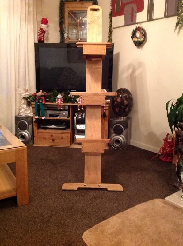

My front leg is 20"wide & the top rung for the seat is at 45 inches , it allows me to observe at my 16" lightbridge at zenith even on the JMI wheelie cart , it's very stable even when sitting at the maximum height, even that height is to high as I had the chair made bigger than I need.
[image]http://Posted Image[/image]

Posted 18 January 2013 - 02:24 PM
I think for a tall chair the front brace ( foot ) needs to be at the front for stability as tht is where all the weight is , even though my foot is 20" it doesn't get in the way as the only time it is right next to the scope base is at zenith , and even then it's in just the right place ( the lightbridge is considered wide (big) by most people) I don't think the tripping hazard is relevant because you can't trip over it when your sitting on the chair and its never that close to the scope when ya moving it to line up targets , it gets put near the scope when you're lined up and ready to sit.

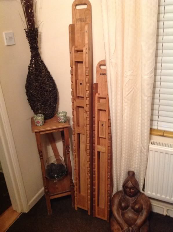

I used Shaun's plans to make my chair and I put the brace in front per the plans and because I'm a big guy. On mine I made an adaptation where I use black bolt like things so I can take the front brace off for transport. In thinking through it, I am sure a design could be made to allow the brace to be on the front or back depending on the user. For me, I'm glad mine is up front and I haven't had a problem with the chair at all or using it with my scope. My chair goes up I believe around 44 inches or 46 inches and I have been at max height on it.
You can incorporate a way to hold the foot on the back of the chair also a little slide lid box to store the bolts,
You can then transport it easily as one unit
